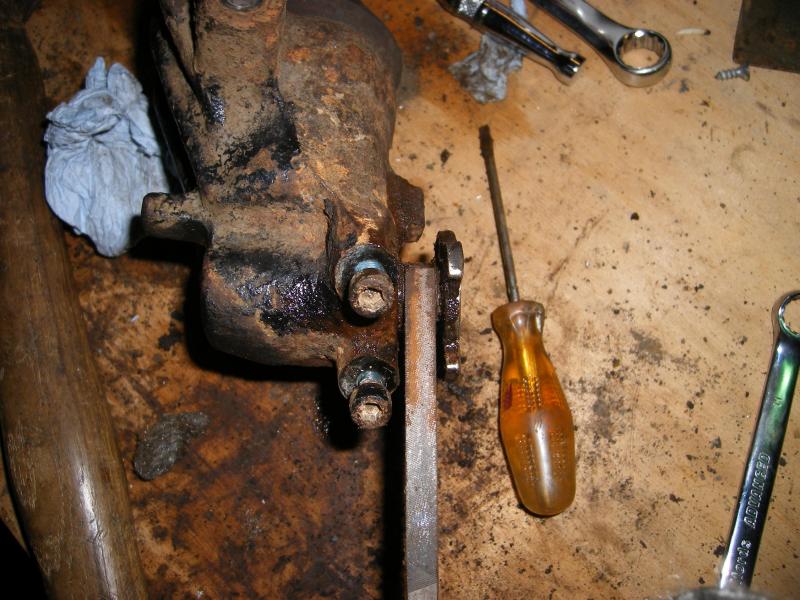

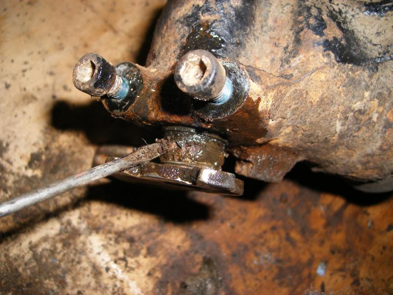

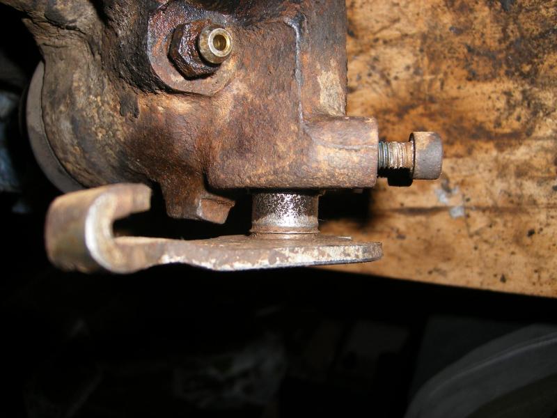

Default Temp repair for handbrake
Need to remove the caliper from the car really as a bench and vice come in handy and working under a wheel arch outside in the rain isn't the best.
Caliper on the bench with the return spring removed, a little care needs to be taken as the spring it under a bit of tension.
Looking at the dirt bild up between the handbrake lever and the caliper body.
I used loads of 3in1 with a bit of white sprits to thin it down and worked the leaver back and forward untill my hands were sore. Then a large screwdriver between the lever and body and with a wiggle, twist and a bit of levering it will come away from the body.
Leaving this. I, like John, couldn't get the lever all the way out. (on either caliper)
Looking down and the dirt / rust build up is thick.

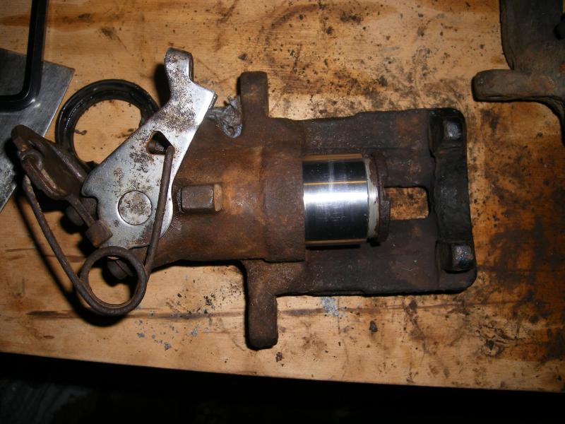

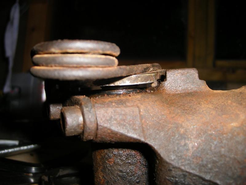

Scraped at the muck with a small screwdriver (is all i had) got it back to a reasonable state.
Then filed it smooth (ish)
But was left with some pitting. I used loads of brake cleaner and blue paper roll between these photos.
Put back together with plenty of 3in1 oil working it all the time. You can actually see the rubber seal now.
New inside seal fitted as Audi came good with the kit. Just the dust seal to fit.
The handbrake leaver was moving back on it's own without the spring fitted and before it was cleaned i had to tap it with a hammer to move it.
The seal between the leaver and the body on one caliper is shot and put it down to the amount of build up on the bar. This seal is not in the repair kit and would think that it's only time before i get more trouble.
Maybe if it were kept clean and well lubricated in there the seal would be ok and it would last for years.
Oh i did both side but would suggest keeping one caliper complete for referance as it is not obvious how the spring goes back.
