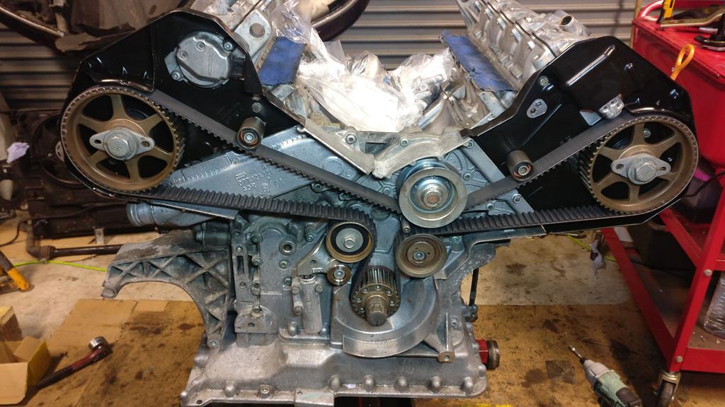

The timing belt arrived today, which was nice. I'm using a Gates belt here as they're an OEM for this sort of thing.

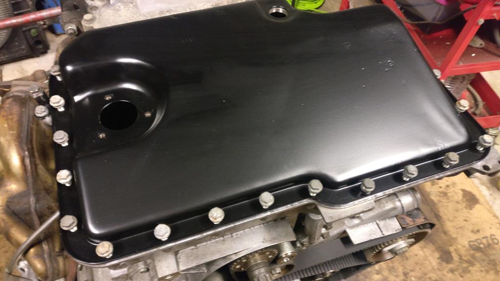

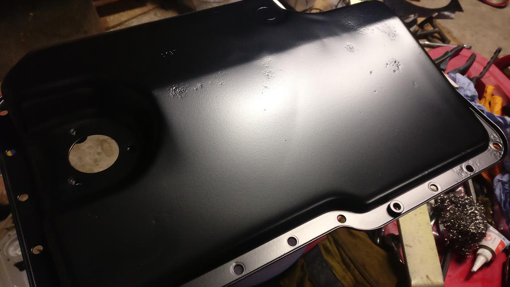

Craig who does tig welding also does powdercoating as part of his wheel refurbishment business (The Ally Cat in Crediton). I have been quite set against powdercoating in the past because of its tendency to split along sharp edge, however Craig being a perfectionist like myself has learned how to tune the setup of the kit to avoid this problem. As he's providing a boutique service, rather than maximum throughput for minimum cost like most such establishments, he can spend the time to get it right which I am more than happy to pay for I'm very cautious about painting the inside of sumps as not much can withstand 180 degree oil, and loose sheets of paint can easily clog up the oil pump. In this instance, Craig blasted and coated the outside but didn't touch the factory coating on the inside.
Tl;dr - I had the sump powdercoated satin black It came out rather smart, and saved me a ton of time painting it.

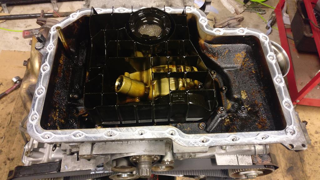

This really is the only way to successfully seal these things properly - take the engine out and flip it over With the engine in the car there is guaranteed to be a drip of oil somewhere which will ruin the sealant, no matter how much you clean it. I've not bothered cleaning the carbon deposits in here, because they're everywhere in the bottom end so it would be for visual effect only. If any of this drops off it'll get captured by the filter anyway.
All the bolts in, tighten in a diagonal pattern to avoid distorting the pan

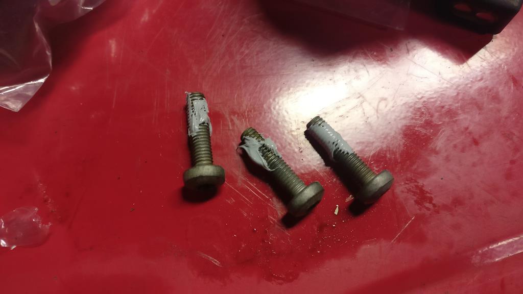

These are for the oil sensor and need sealant on the threads. Its surprisingly common for replacement sensors to be fitted without sealant on the bolts, and then of course they leak everywhere.

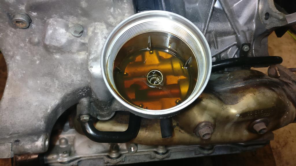

I dislike the bare paper oil filters because you can't fill them up after an oil change, meaning the engine has to move 1/2 a litre of oil at least before the bearings see any lubrication. Except you can pre-fill when its upside down

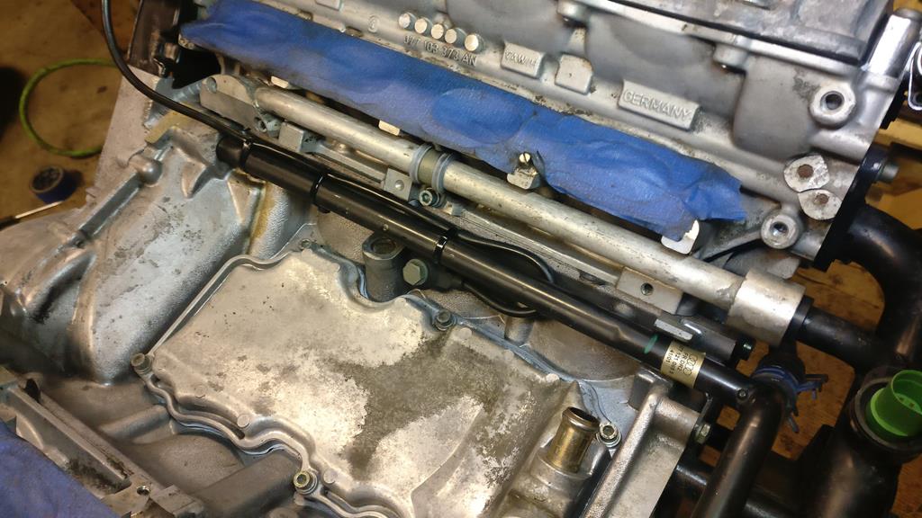

Now the sump is on and the engine is staying the right way up the water pipes can go back on. These don't clear the engine stand so I can't flip it with them attached.
