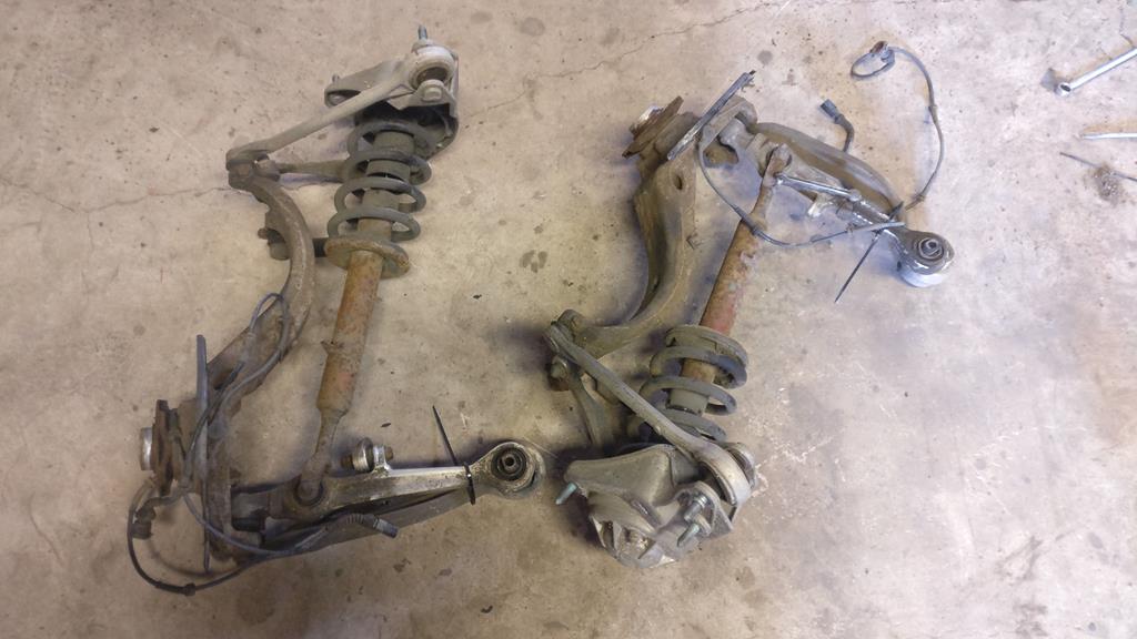

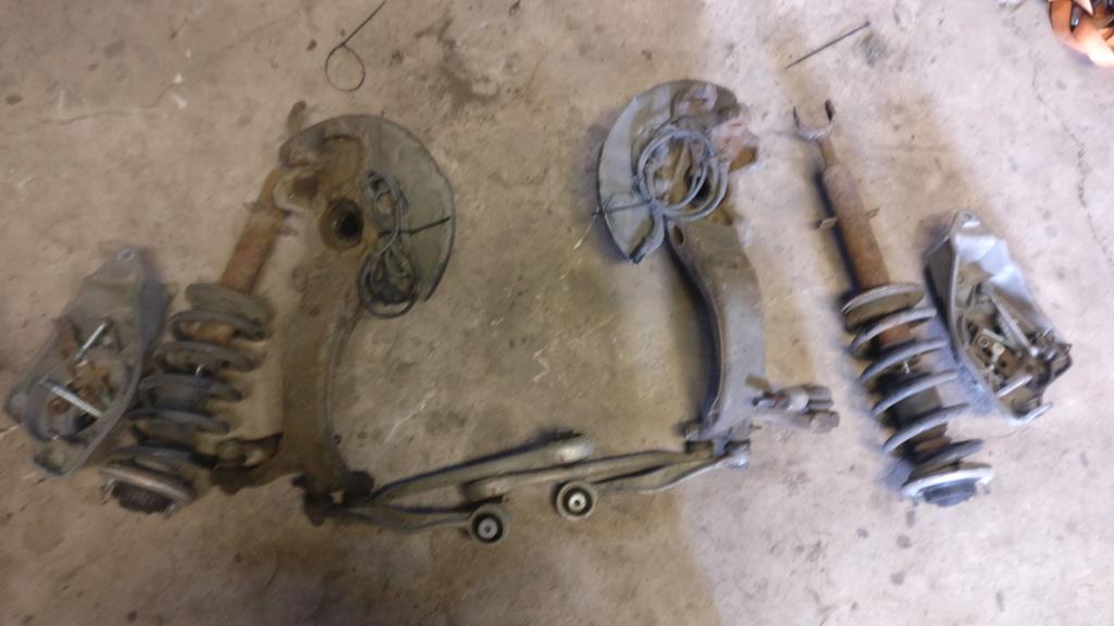

I fitted the lower control arms and driveshafts on to the subframe earlier in the week. This makes everything much easier to put back together.
This evening I removed the front suspension
Potato-cam picture sorry Struts and lower arms removed and broken down as much as I can. I'll make a start on the seized pinch bolts and track rod ends tomorrow. These will probably be a couple of hours each as they are properly stuck.

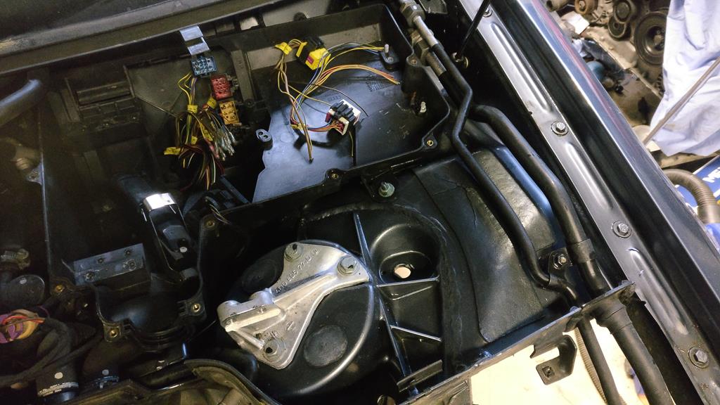

Old 4th June 2021, 09:13 PM

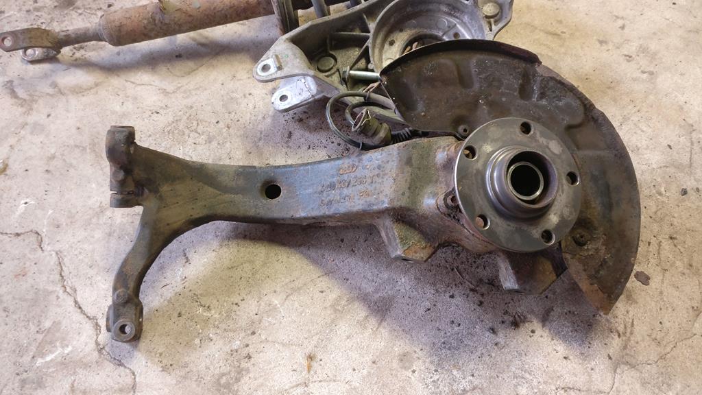

A pleasant surprise with the suspension - the tie rod ends wouldn't budge on the car and I didn't even bother trying the pinch bolts. Once I had the uprights in the vice and could get some proper force on them everything just came apart without a fight I had both stripped in an hour.

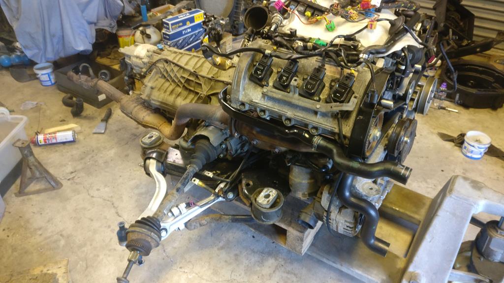

I started cleaning the engine bay and vaccuming out the detritus from the scuttle. There was quite a lot!

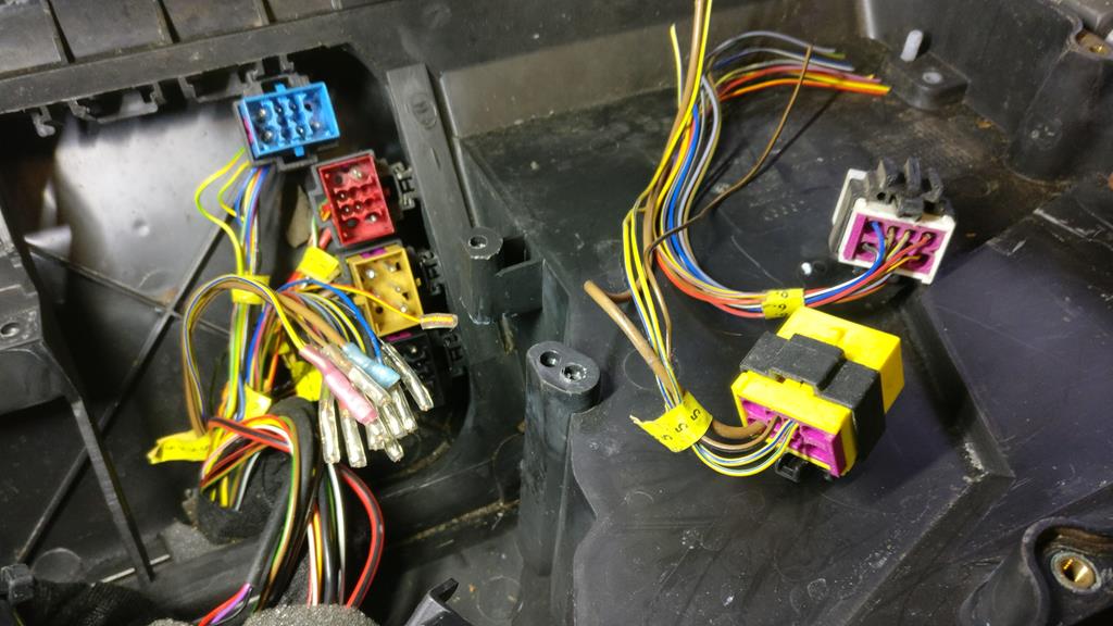

Cleaned up around the ECU box so I can do Botang's hole in the morning. You can also see the two new connectors to repair the wiring harness. These are from Sergey's car, the parts from which continue to keep the others going.

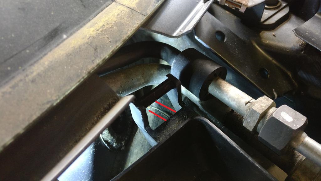

MJ could you take some pics of botangs hole, I've never really got my head around where it is

Hmm,my FL A8 also has steel front uprights and it doesn't have those screws that hold the discs down.. strange
  #68
Old 4th June 2021, 09:47 PM
No longitudinal Audis (of this era) have screws holding the brake discs on, for no obvious reason. Golf-derived models like the A3 and TT have them. More expensive / upmarket models just have the discs fall on the floor when you take the caliper off
Mark, check out the following post by MJ:
http://forum.a8parts.co.uk/showpost....2&postcount=16
  #70

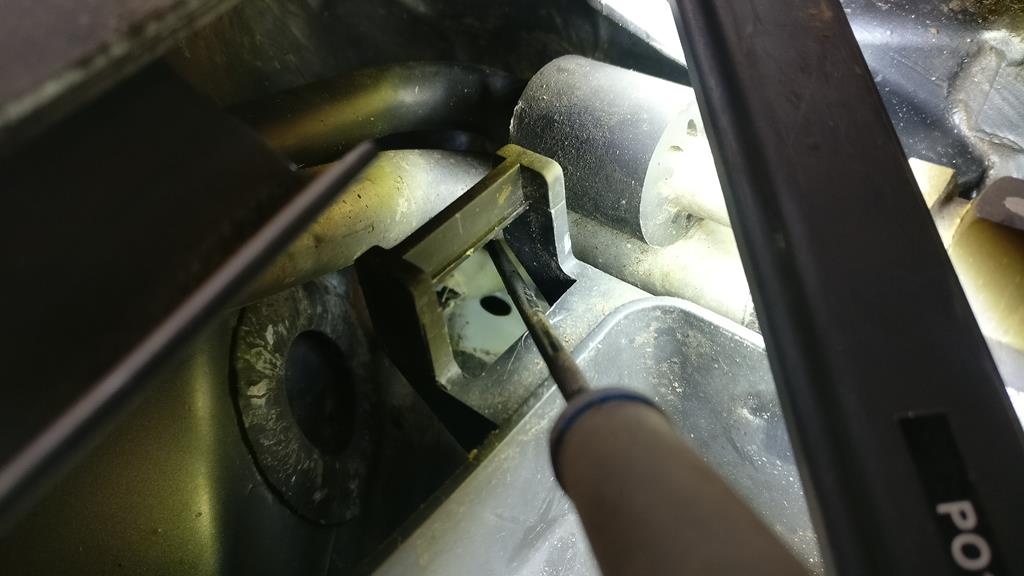

Old 5th June 2021, 09:10 PM

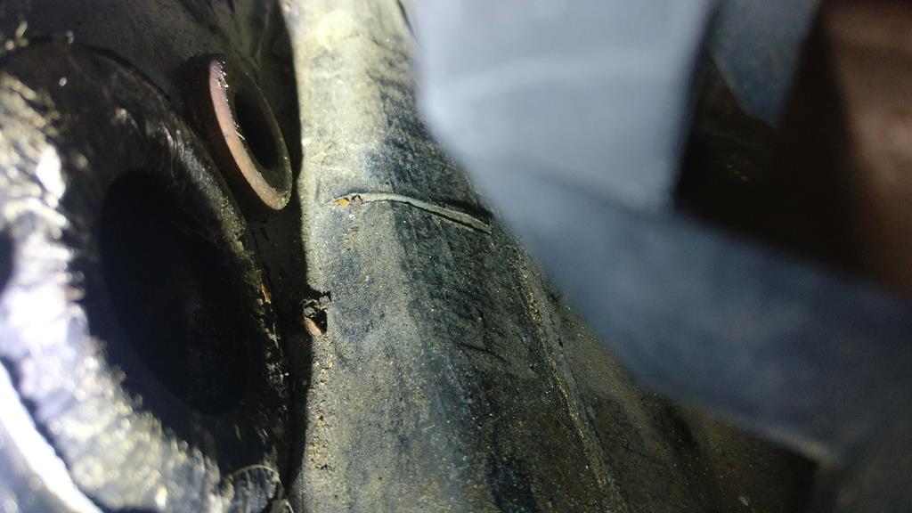

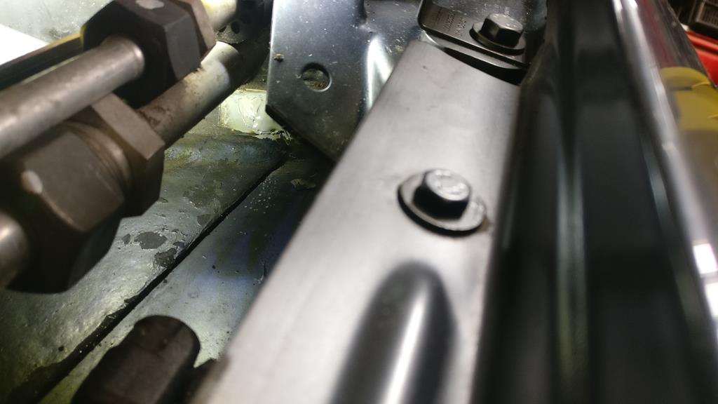

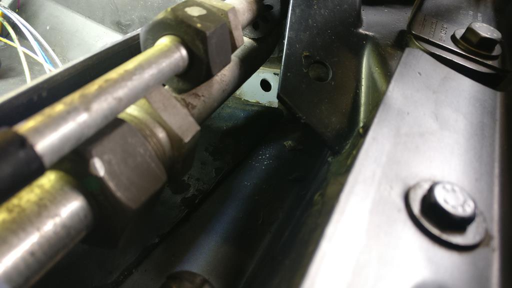

The tape is intact but beginning to peel so I'll fix it permanently while access is less difficult than normal
Zoomed out view
Peel the tape off with a pick - its not leaking yet, but its only a matter of time

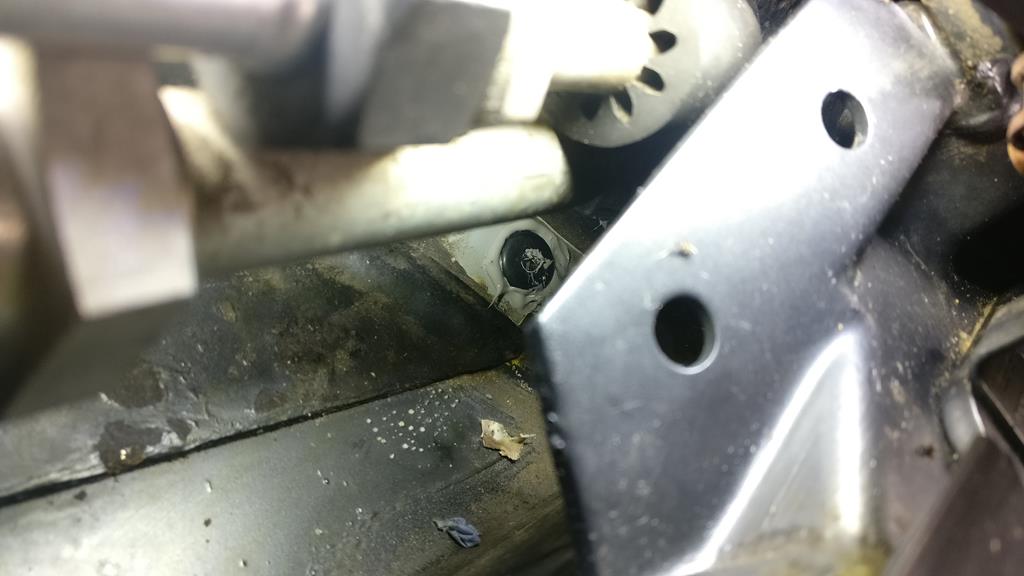

The hole
An out-of-focus plastic rivet

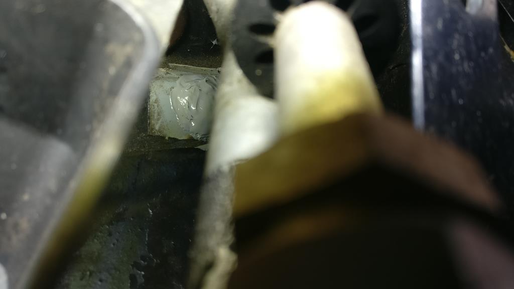

Pushed in to the hole with some seam sealer
and covered over with more seam sealer

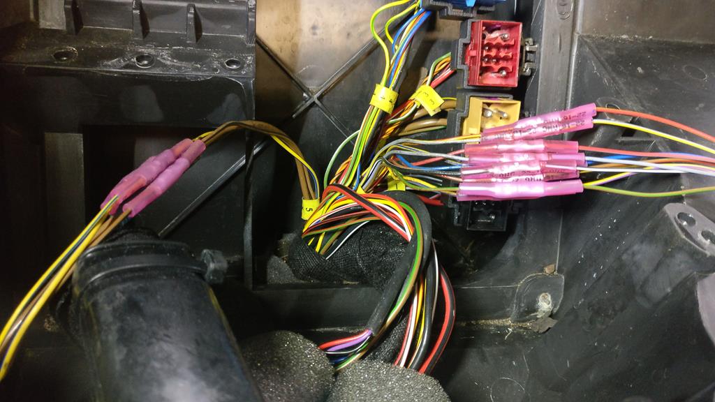

On to the wiring harness. Previously spliced wires on the left, replacement connectors on the right.
Crimped and heat-shrunk
Some Tesa tape to act as a strain relief and to stop them rattling
Wires tucked away and the connectors back in place
Then cleaned the engine bay
I did the other side too, but forgot to take any pics. A little more tidying underneath in the morning and then the engine can go back in
