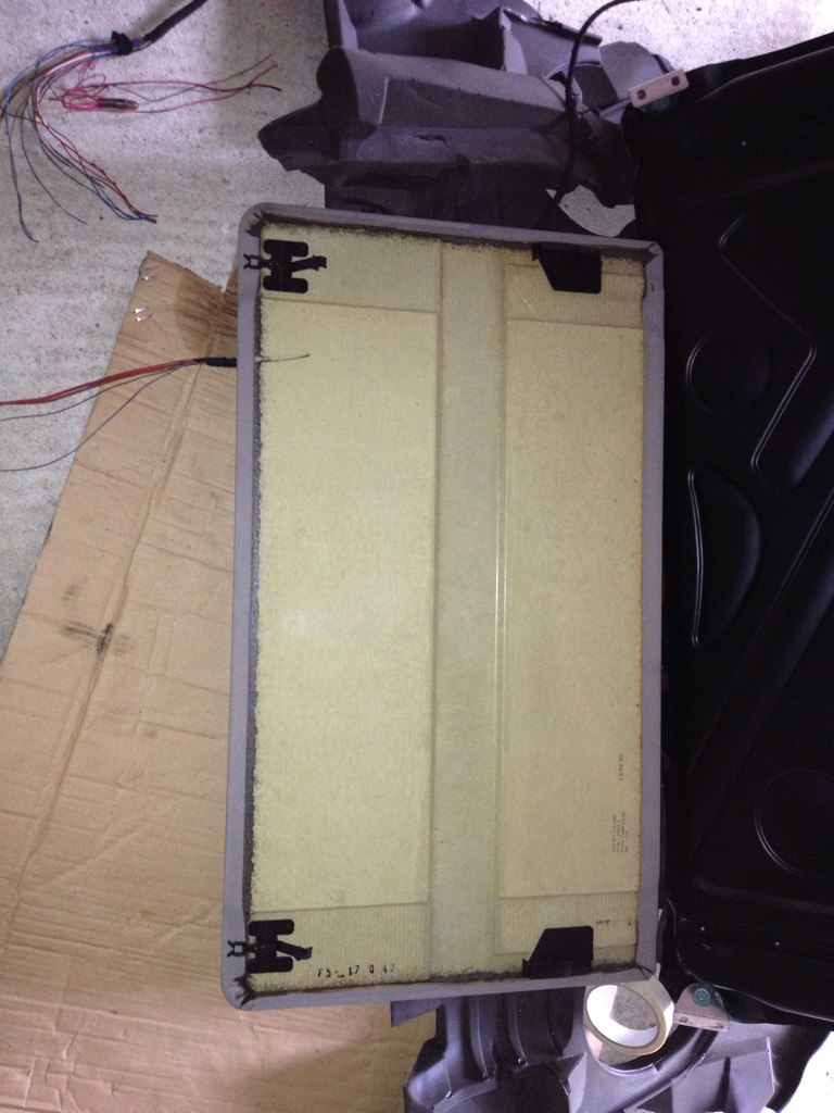

I'm struggling to find a thread I'm sure I posted of stripping down a spare solar roof panel, with the intention of retrofitting to the FE. As MJ says the cover is separate - from memory it's just a couple of spring clips holding it in place on the solar and metal panels. I think it comes out with the roof tilted up, once freed off. Hopefully the glass one isn't massively different in layout?
If all else fails, I seem to recall the actual panel is only held in by a handful of bolts.....
