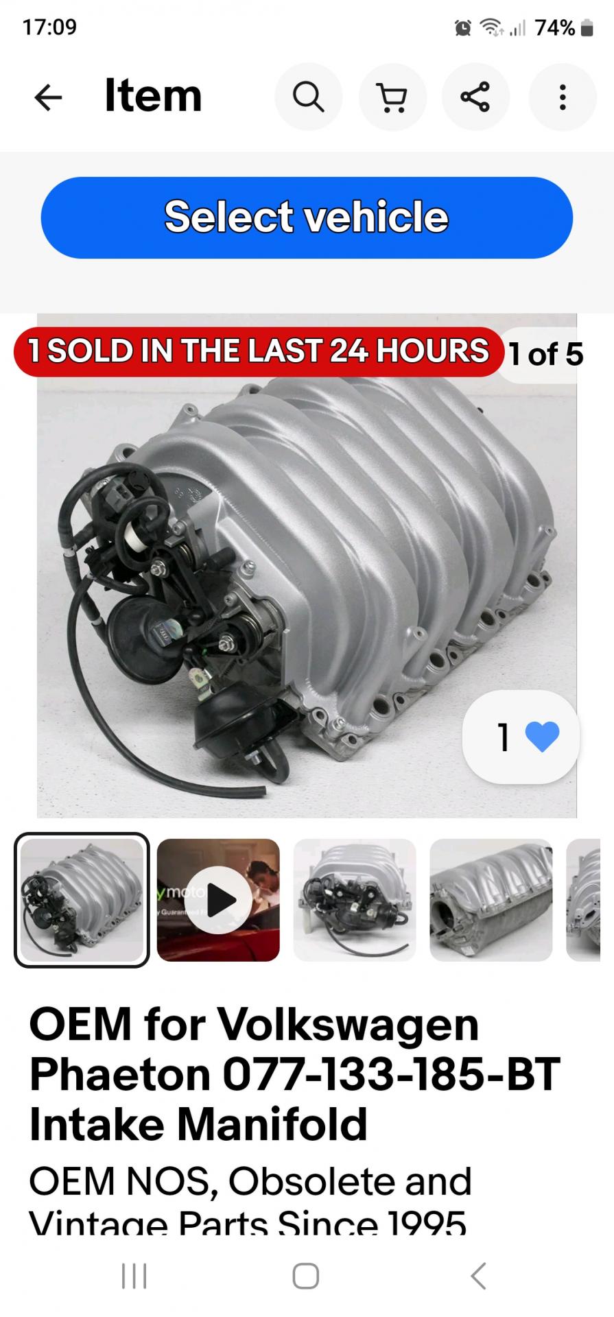

Just ordered this one from the US. Gonna be a pain as I had to use a freight forwarding company (shipito) as they wouldn't ship to the UK. I think it will work out at about £1500 landed which was about my limit.

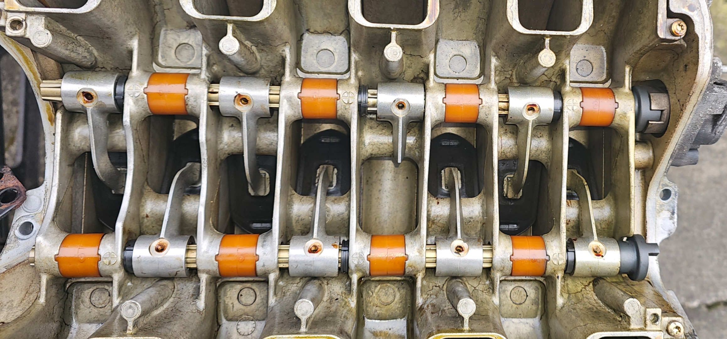

I opened up my broken manifold and you can see hear clearly where she broke.
I am wondering if it would be possible to remove the plastic flap, weld the broken arm, then securely reattach the plastic flap.
Just looking at the photos again, isn't it a very unusual part to break? I always thought that it was just the plastic flaps that deteriorated over time, got brittle and broke off. Although, you could say he was 'lucky' in that there was no way part of the arm and the flap were going to drop into the cylinder, unlike small bits of plastic.
