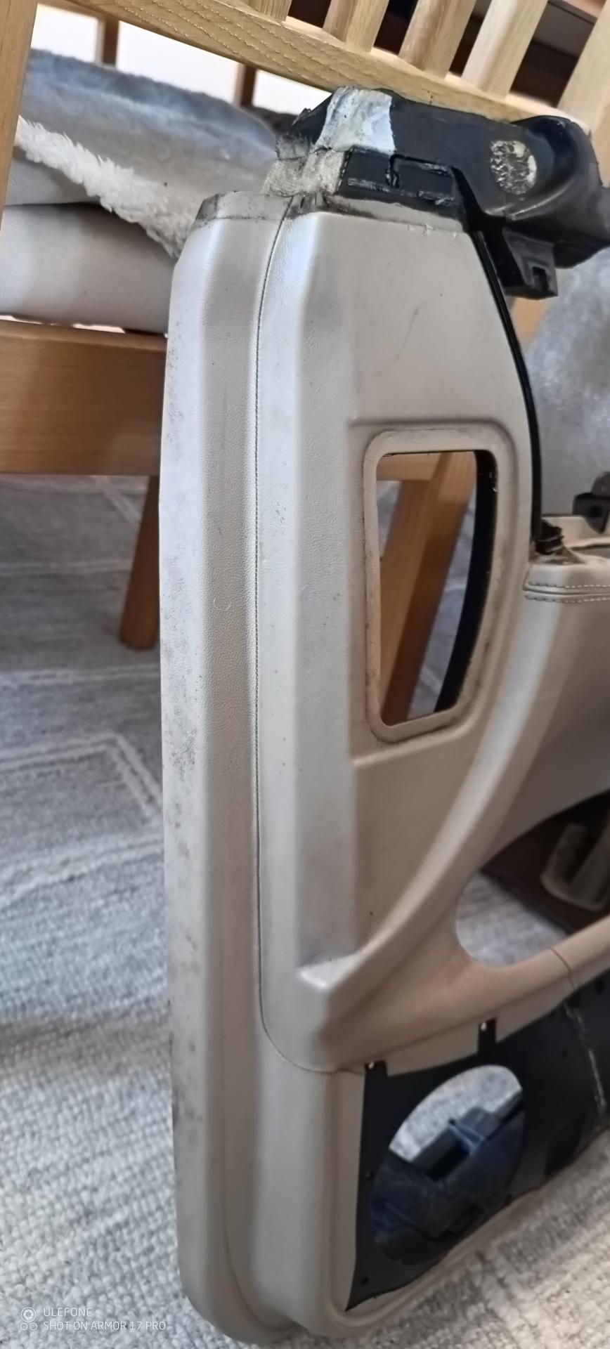

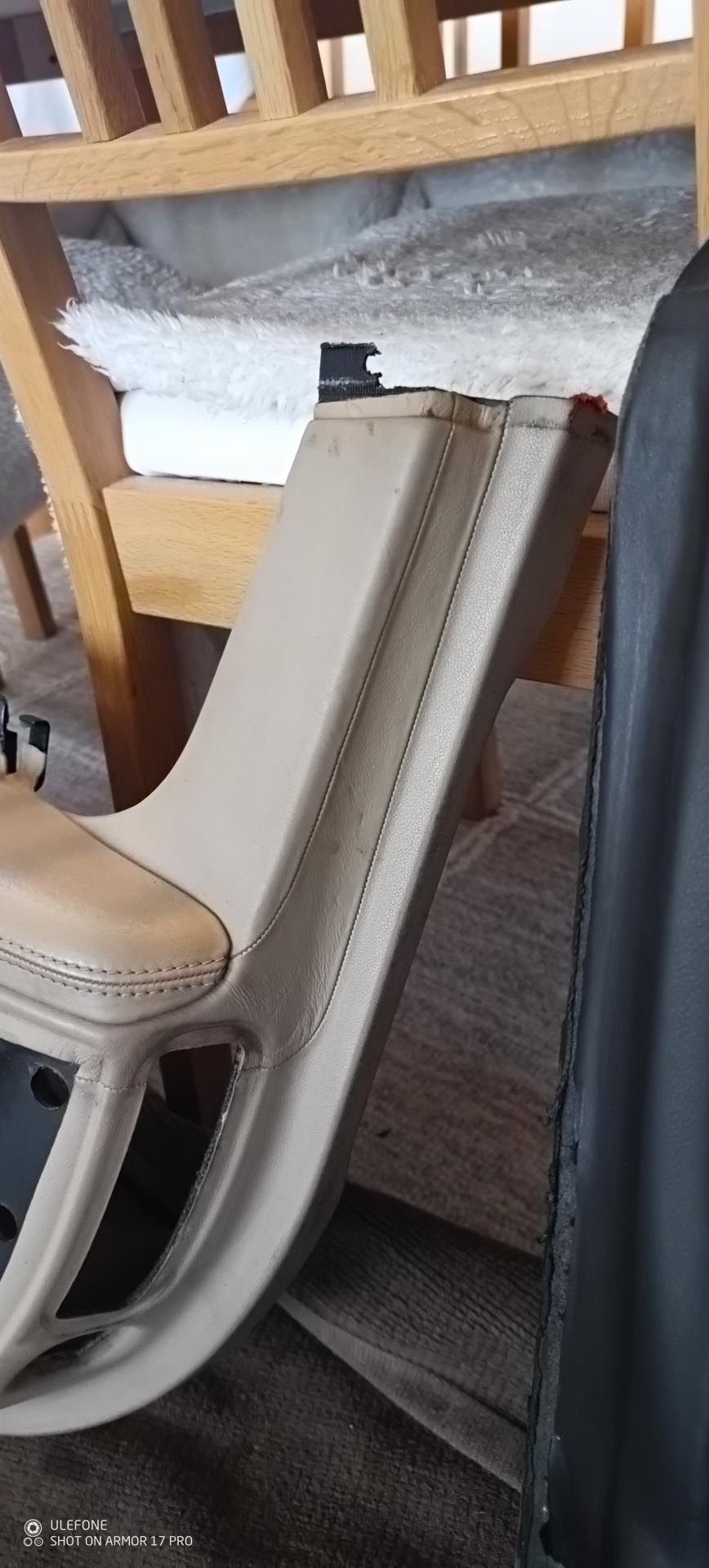

Nothing done on the project over the winter but today some front door panels arrived. I managed to find a set of updated facelift leather pack 2 door cards that have the mold issue sorted. I'll post some picture but these are the updated door cards audi fitted when customers complained about the mold destroying the border.
They are from a 2002 so maybe then they were fitting the updated ones as standard but that's just a guess.
I disassembled them to prepare for black dye and adding on the leather pack 3 parts.
