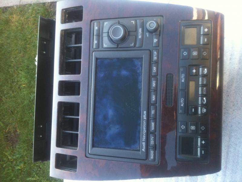

Well I managed to obtain a double din fascia from a8parts a couple weeks ago
At present, I have just managed to cut the rnse fascia down to size....
I am now waiting for some other bits....
1.I have decided to try update the wood interior effect with the carbon fibre effect...so now waiting for the roll to come through.
2.In the mean time I need to work out which adapter I need to connect the rnse to my car
3.Cos the pf doesnt have canbus...I have ordered Facelift instrument cluster from a8 parts....(I have found a diy on line on how to link into the canbus wiring so hopefully all should go well.
4.My car didnt have satnav...so I will need to source the satnav module to go on to the boot also....That should be fun....
Watch this space....
Name:	Rnse cut down to fit.jpg

I'd just put a modern gps antenna behind the dash - a LOT less hassle and prob more effective too. Should be able to get 1 from wherever you get your wiring adaptor from

I saw those on the kufatec website...but I wasn't sure it would work due to the double windows.
But if it does then great...I ll do that n put a box on the back for the look in time.

It should work fine - it'll be 'looking' through the windscreen from under the dash anyway. It'll be easy enough to test when you 1st install the RNS-E and you can check how many satellites it's picking up in one of the nav screens. About 6 ought to be average - can always compare to Amar's RS6 RNS-E if it happens to be close by to check it's getting comparable reception for the location
I wouldn't bother with the box on the tailgate - it's just something else to leak etc if you retrofit.

You will need to have the facelift instrument cluster coded to the car I'm quite sure, you should have gone for an S8 one as you get the white dials too and they look much better then an A8 one. Get a £10 GPS receiver from eBay and throw it behind the satnav somewhere, works fine. Worst case scenario as I understand it if the canbus doesn't work then the unit won't switch off when you pull the key out or light up when you put the lights on, it won't display sat nav instructions on a D2 with or without canbus anyway, just track names. Your going to have to make it work now you've cut it to size. It looks good in there. Speak to Ben Wardle at Shark Performance about coding, he's a top guy.
