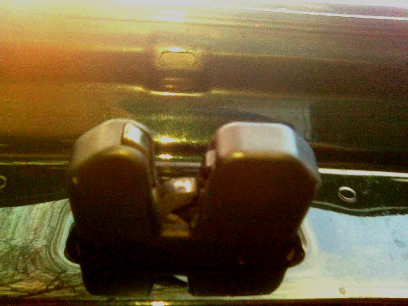

Looking again I found a small rectangular grommet in the centre which is "lower" with the boot shut, so I've taken that out and replaced the round ones in the corners.
It's only about 10mm by 4mm but should be more than adequate as a drainage hole.
On the down side my bloody scuttle drain is blocked again.
Picture attached of the hole in the centre close to the boot latch, with plug removed:

The water is still getting into the boot lid somehow and I've no idea where.
The grommet around the air pipe has now been sealed and anyway I haven't been driving anywhere in the rain for a while (surprisingly!). I put the 3 grommets along the bottom edge back at the same time though.
The boot lid was definitely dry the other day, yet when I opened it earlier today water came out, not masses, but some. Since I was certain it was dry it's been sitting out in the rain, but not moving.
As a short-term remedy I've taken the small rectangular grommet near the latch out again.
