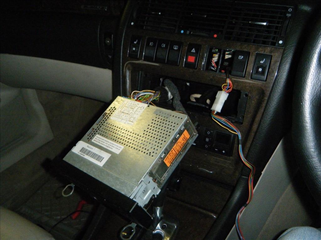

Undaunted I started by removing the radio and a couple of switch blanks.
The cableing coming out of the blank is my LPG switch/indicator.
Basically, there is a loom that plugs in between the radio and 2 of the plugs at the back. You then run the Mic, Screen and accessory leads and plug them all in.

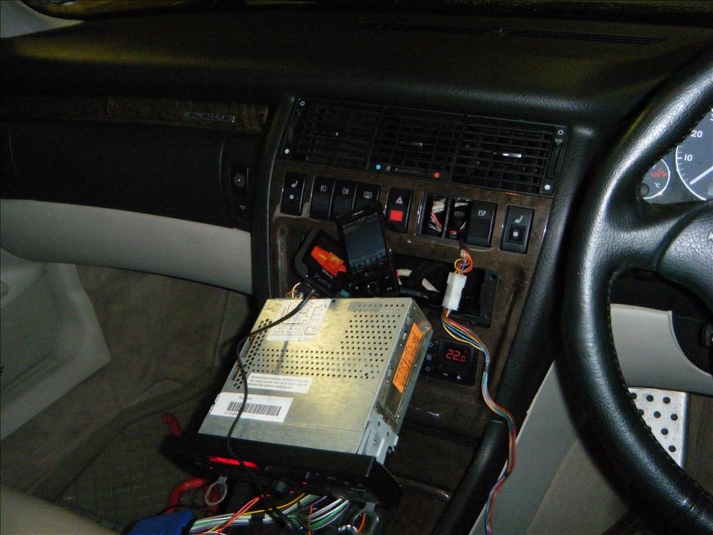

This is me testing it all before it goes back.

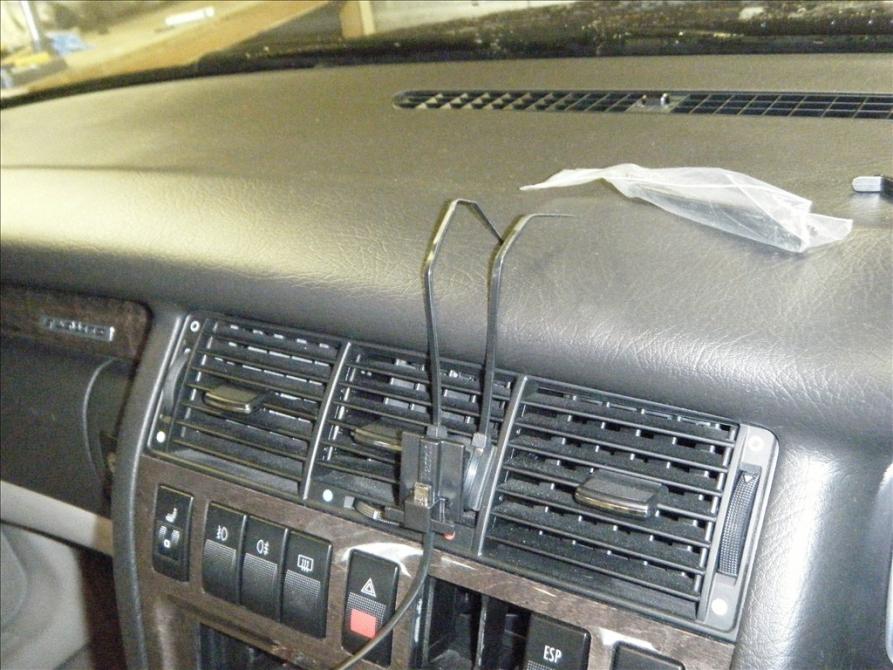

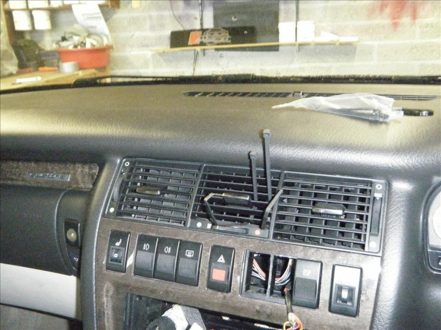

I mounted the screen on the centre vents,
I then cut a wee valley in the top of a blank and ran the lead to the back of the Climate Control where I was putting the control box,
Then it was reassemble it all,

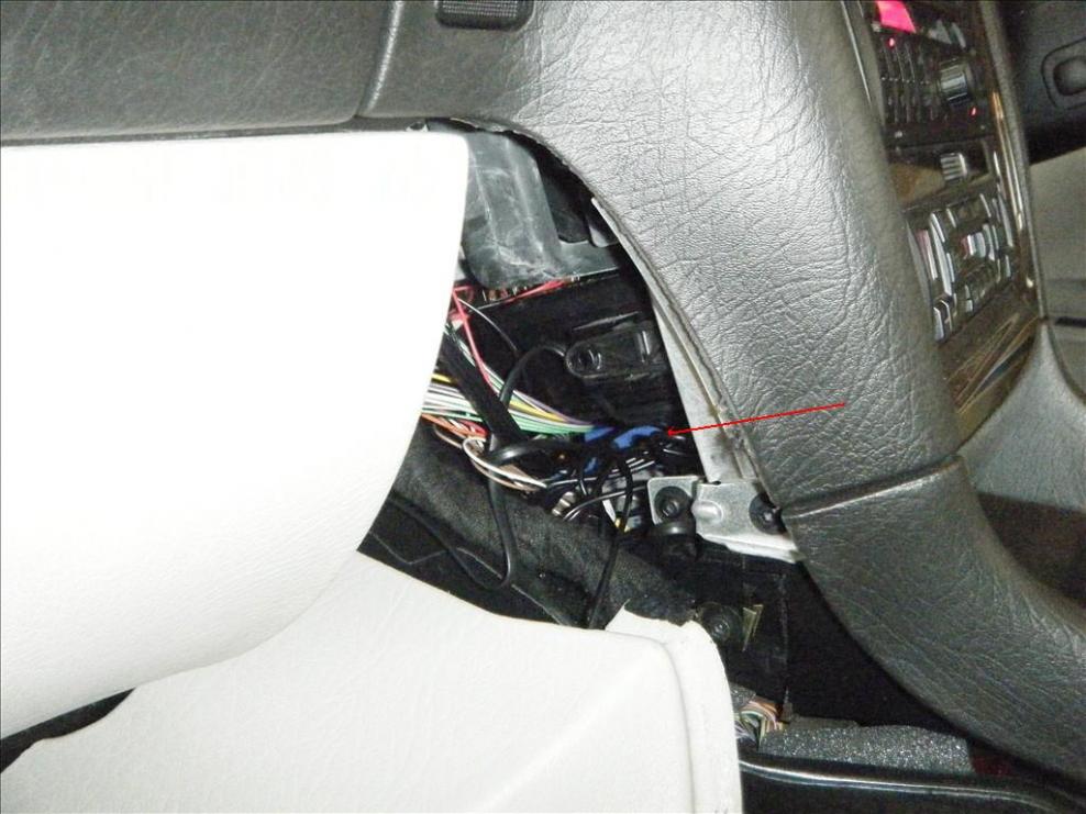

The mics' are stuck in front of the instrument pod and the cable run behind.
The control box is behind the passengers tunnel panel below the climate control and the bluetooth works just fine.
