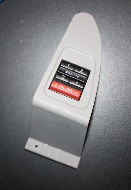

Now, what I didnt realise was that it comes with a different memory button :
Somehow, we removed this part from the donor car, completely overlooked it and put it in a box several months ago.
Last week, David found it and excitedly told me he'd found the missing passenger side memory buttons i'd been looking for, and it has a * button on it... how cool....
But when i got it, it isnt a passenger side trim.... Its a drivers side trim...
So, a quick double check with a 2002 owners manual and a lot of pieces fall into place.
The passenger side memory buttons are normal, 1,2,3,4 buttons just like you normally get on the drivers side. The drivers side however has 3 positions, 1,2,3 and * - The * on the drivers side module (wait for it) moves the passenger seat into its position 4, so if you've had someone lounging in the back who has pushed the front seat all the way forward, the driver can simply press a button in his door to move the seat back to a sensible position.
How utterly fab is that.....
This also explains why I ran that white/green wire all the way from the passenger side memory buttons all over to the drivers side memory buttons.... I thought it was odd, but did it anyway because i couldnt explain what it did and Im so glad as I will now have this feature when I refit the seats.....

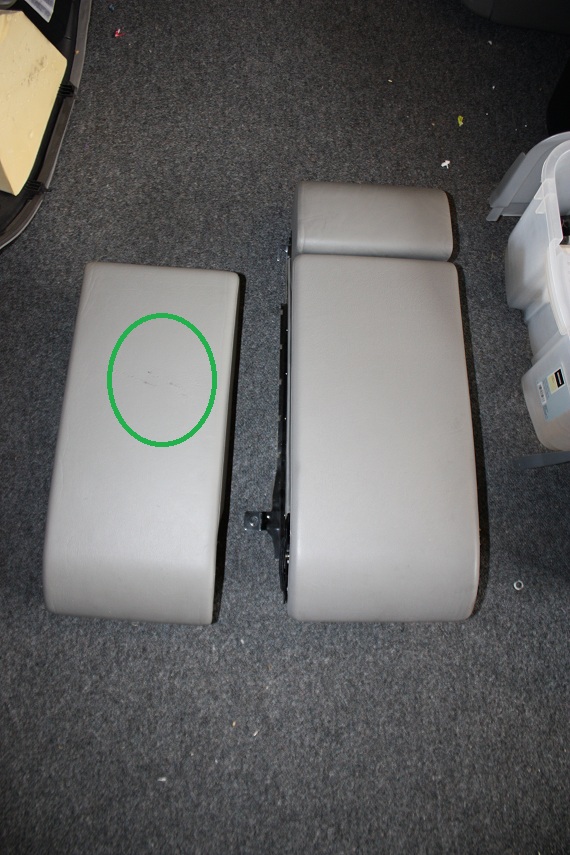

I've sorted a few other niggles. Here is a photo of the original armrest from the donor car with individual rear seats on the left. In the circle are 3 annoying dings which are common to the armrest section as it is hard and doesnt suffer knocks well. I had a much better armrest in my original back seats so decided to swop them over....

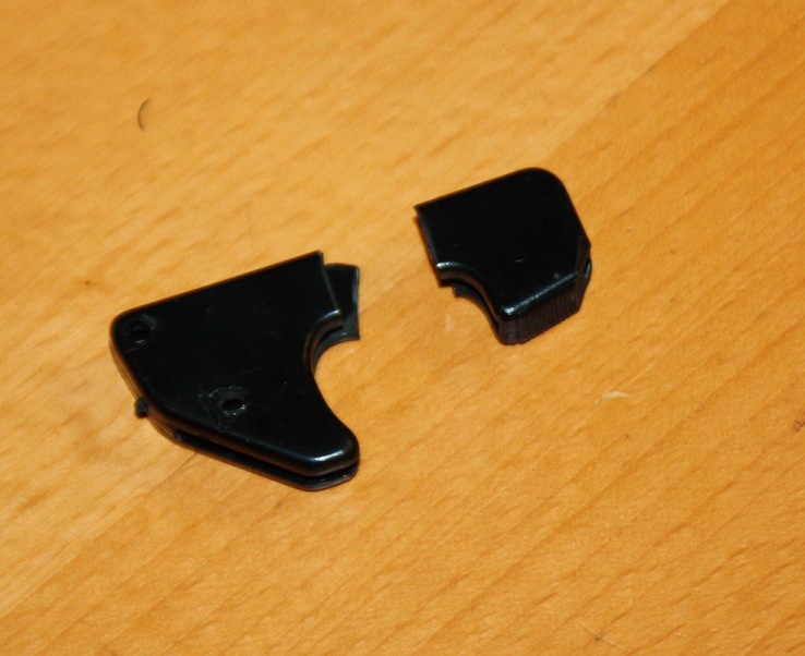

Of course it wasnt straight forward though as the whole bracket (seen on the right) is completely different for the individual seats. For a starters, the center headrest doesnt pop up like normal FL D2's because there is no center seat, and the shape differs to protrude further to allow for the seats sliding out. So, I then had to dismantle the whole assembly on the right, which is typically german overengineered combination of levers and c-clips but in the process managed to break a plastic retaining bracket
Plastic? seriously... anyway, a good session with superglue seems to have sorted it out, and its now all re-assembled and looking good as seen on the right...

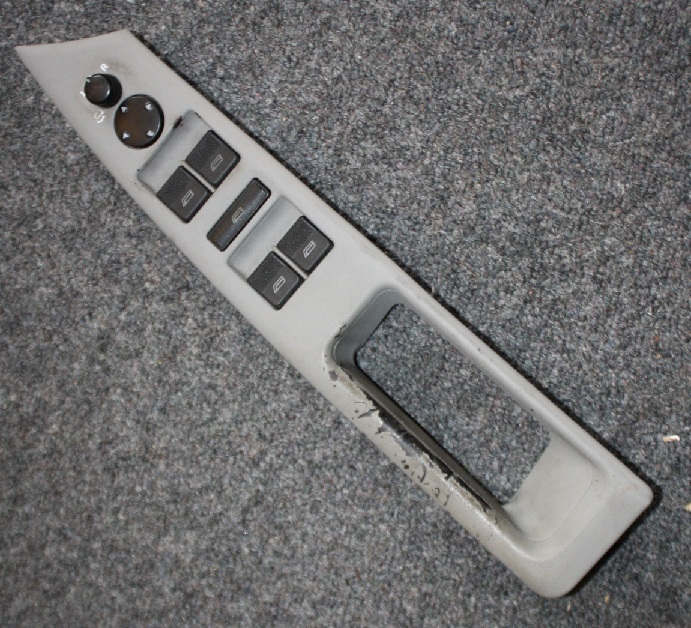

This is the state of the drivers one from the donor car:
The 'wood' trims wear far better, but the plastic colour coded ones generally look less old-manish as the wood isnt overpowering, and it simplifies the process of changing wood at a later date.
What a lot of people dont realise is that wood trims on the door have a wood top, but the insert round the handle is coloured to your interior. There are 8 or so interior colours, and 5/6 wood trims, plus rhd, lhd and then whether you have auto-mirror folding so thats 80+ different rhd trims alone. The chances of getting a match if you want to change wood over is sometimes very slim, so by sticking to a colour-coded switch trim, you can avoid this problem later on.... So, I've order some brand spanking new ones to finish my motor off properly, and leave me options for changing the birds eye later if i get bored...
