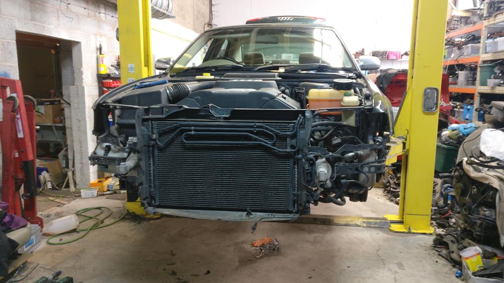

Got the front end off today without too much fuss.

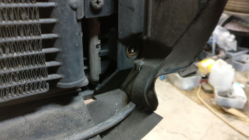

The only bits which fought back are the two lower bolts of the radiator air guides, but those are simple enough to drill the heads off.
Front panel off
Overall this one is in very good condition, which is a pleasant surprise after the struggles with the murple and barnfind. Both subframes have some surface rust but are entirely sound which is a bonus.

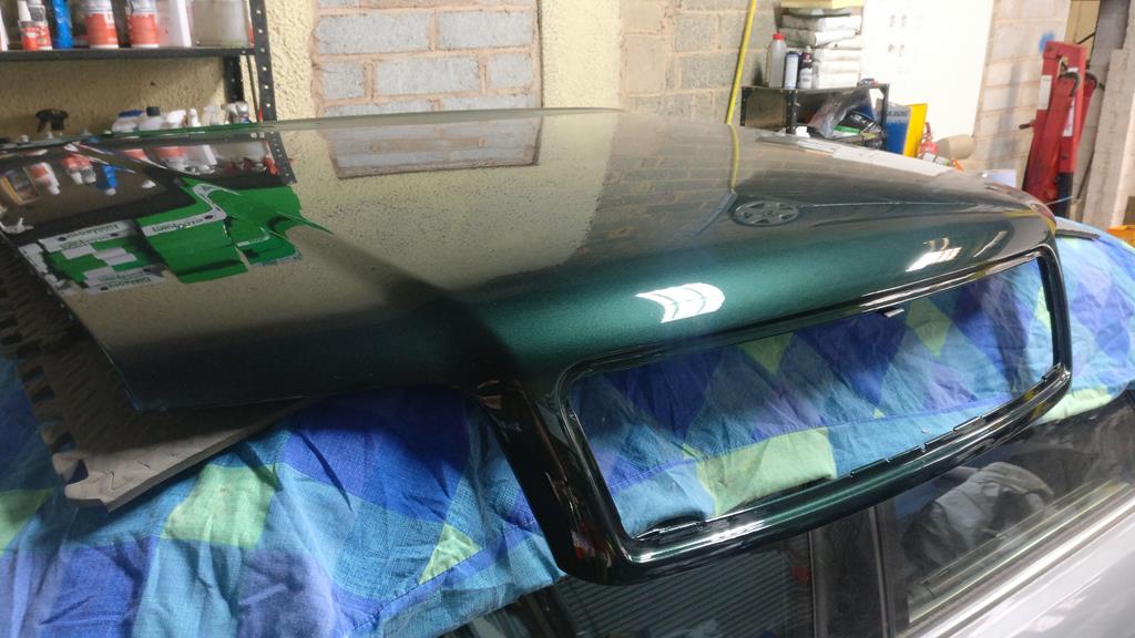

The bonnet is back from paint and they have made a very nice job of it
This is how the special roof rack works - the catches are removed and replaced with some M8 threaded bar which attaches to the right hand side of the rack
and the left hand side of the rack attaches to the hinge holes.
The bonnet is solid on here without touching the fresh paint

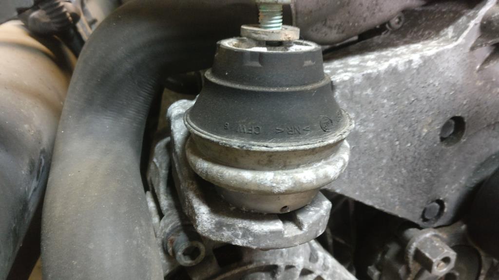

I think this is the first one I've encountered where the original snub mount is still intact
