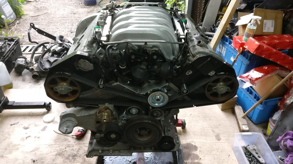

I did the bank 2 tensioner last night - that was also in perfect condition, so filter removed and new pads fitted, then back together

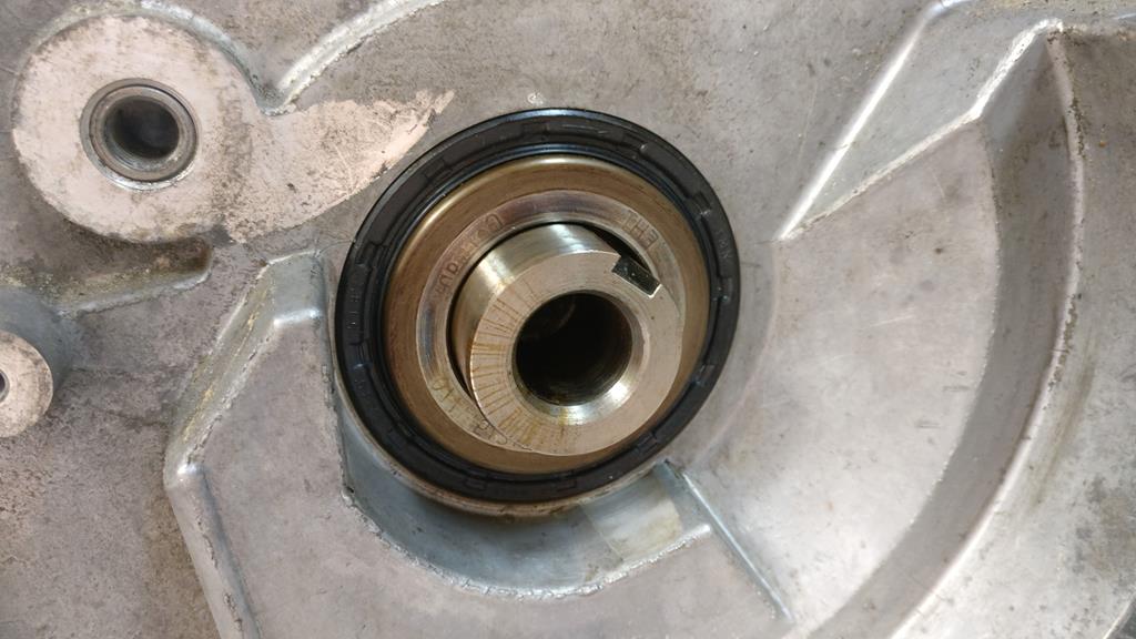

The front crank seal was weeping a little so that needs changing

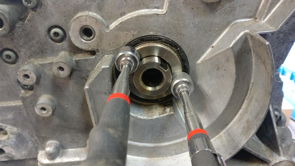

Pull the bushing out with a couple of magnetic pick-up tools
Cleaned up ready for the new seal

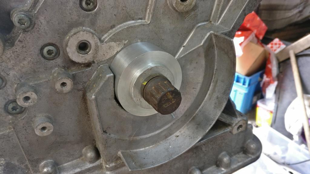

I made a new tool for fitting the seal as my previous one wouldn't push them in straight. This one pushes the seal properly square by using the sprocket bolt, similar to how the factory tool works, although mine still assembles the seal and bushing together rather than putting the bushing in later.
All done

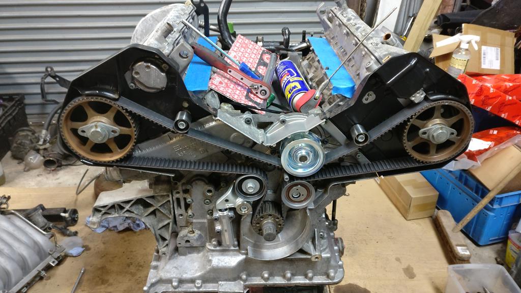

Torque the new sprocket bolt to 200Nm + 180°, then put the new belt kit on

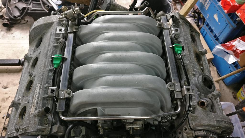

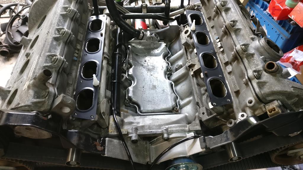

Ready for the inlet manifold
I discovered some time ago that the factory put sealant on both sides of the inlet manifold gasket, so I do the same.
Manifold back on
It cleaned up quite well
Aux belt rollers back on and the engine is pretty much done for now
Gearbox tomorrow

  #38
Old 9th May 2022, 01:53 PM
Posts: 3,227
Does it come out that easily?
Is that part number 077115147A (radial shaft seal), as it seems to be from the old ETKA diagram?

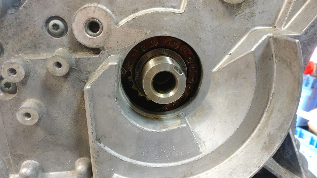

All done
Is there a part number for the seal or do you reuse it? Also, does it matter that it's the other way around (text stamped on it but not on photo further up)?
How do you torque it up to that crazy figure?
  #39
Old 9th May 2022, 03:30 PM
Usually yes. Its clamped between the crank sprocket and oil pump sprocket, so with the crank sprocket removed its basically just a fat washer with some oil film and the oil seal holding it in place. The trick is to pull it off straight. If you pull on one side it binds on the crank and won't come off, hence the two magnet sticks
Yes
The bushing has to be flipped around when replacing the seal so the new seal runs on a new surface, as the old one wears a groove in to the steel. The writing on the front is an imprint from the oil pump sprocket, which was on the back. In theory you'd probably need to replace it by the time the engine is on its 3rd seal, but we probably won't be allowed to burn dino squeezings any more by the time that comes around anyway.
Well, I like my food and I have a long bar 200Nm on a decent torque wrench is easy enough. I then use a 1M breaker bar and do two turns of 90° (I mark the bolt after 200Nm). The engine would simply flip over on to the floor with that much torque so I stand on one leg of the engine stand and push the bar away from me to keep all the effort in the one system.
  #40
Old 9th May 2022, 04:01 PM
I noticed the "mirror writing" but didn't think about why! Now we know.
Edit: Looking at picture 4 of 12 above you can see where it came from!
